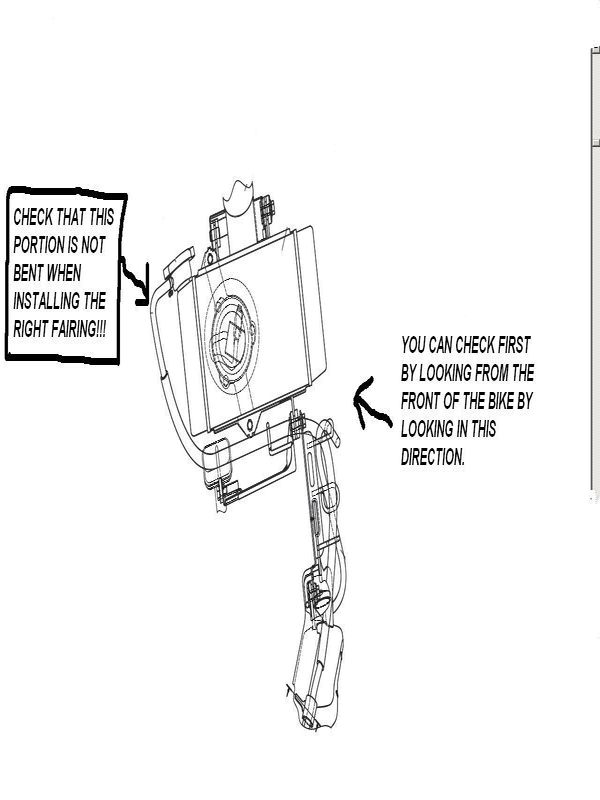

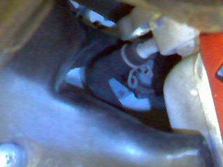

Bros and Gals, whom are riding Spark T135s please check your rubber coolant tube near the radiator cap especially when you fixing back the right fairing after servicing your spark plug, etc.>>>(Refer to picture for more details on which part of the coolant tube i am talking about)
I found the hard way after much headaches and diagnosting what is the problem with my bike inconsistant idling speed, sudden engine stalling for no reason at all, even the engine idling rpms is increase by tuning the carburator.
Found out that above-mentioned tube is bent from improper installation of the right fairing thus causing strain on the coolant pump and engine.
Just sharing what i learnt from this experience....Hope it helps you all.
http://x3f.xanga.com/df409bea462b710806617/z8012352.jpg

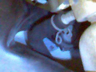

A picture of the tube when the fairing is install properly......

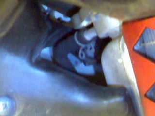

Opps sorry for the unclear picture....still not very good at photography.
Here are the more clear ones.....:thumb:
