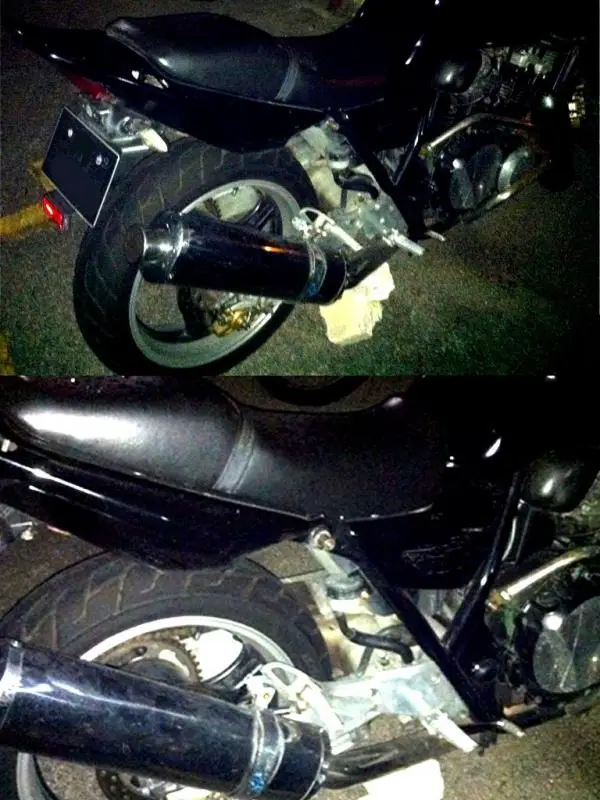

Just to share among you guys since I ride an S4 as well. Saw this bike yesterday when I was in JB. Pity this unknown S4 owner who had his Showa shocks ripped off. Becareful guys. :)
